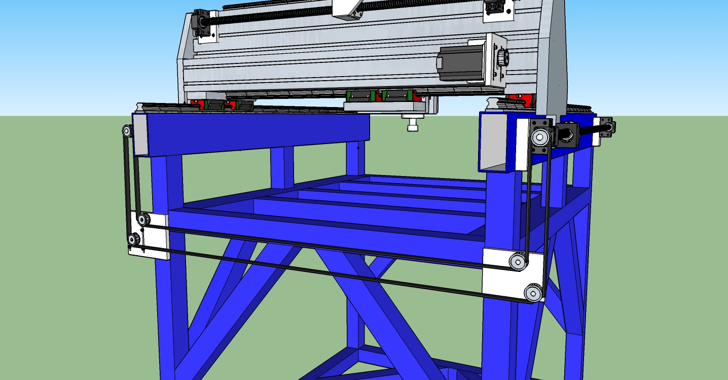

    I'm Going to contradict myself now..!!! . . . If your not going straight across with the belts then I wouldn't bother has it's very complicated and messy with belt that long winding around the machine. Keep it simple else stay with Slaved Motors.
    Yes the belt approach is much more reliable and gives great piece of mind your always in sync. But not if the setup is overly complex it's needing constant attention and with belt this long threading around the back I fear it may cause trouble.?
    So I'd say either change the design and keep it more direct or keep with slaved motors which if properly tuned and connected to good drives don't give too much trouble.

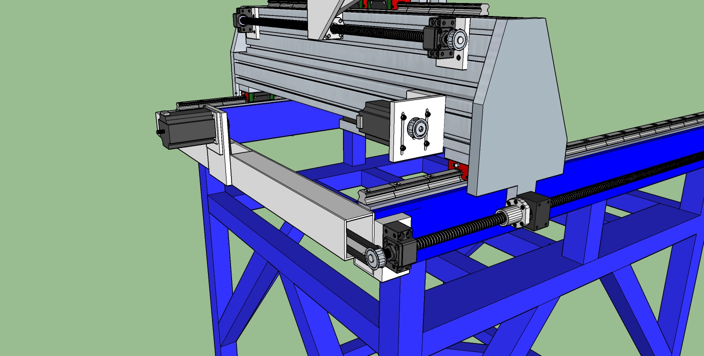

    I am back.
    I have not been able to post mails, because my thread suddenly disappeared. Lee has been very helpful and has recreated most of it. However, there are still some drawings/pictures missing. JAZZ can you please mail the very instructive gantry pictures again and CharlieRam can you also please send your nice drawings again?
    Anyway, I agree with JAZZ, I was not too happy with the very long and complicated belt in my (now missing) drawing. The drawing from CharlieRam is a much better Construction, from a mechanical point of view, but, (as JAZZ also points out) I do not like that it blocks the end of the bed if you need to route long structures.
    Previous drawing with long, complicated belt:
    Drawing where I have put back the extended cantilevers at the top of the machine and moved the now longer, ballscrews, and crossed the belt over directly between them. The bracket serves as cover for the belt, and the motor/idler-pulley assembly goes on top of it, so that it doesn't block the end of the bed.

  6. #25
    I would go even further and make it so that the belt is tightened by some screw that moves the motor up and down. Additional plate that slides or sth similar.

    Great input - thank you.
    Silyavski your idea, with some kind of threaded screw to adjust the belt tensioning, sounds good. I will find a way to implement that.
